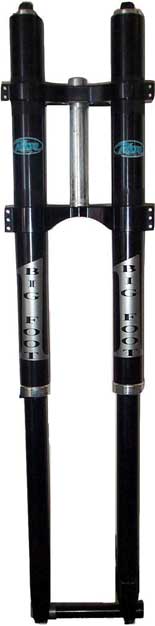

Вот отличный аморт, жаль на велик а не на додж))))) Risse Big Foot 2 тысячи американских денег
Vitals
Oil-damped, Coil Spring
12" travel (1 foot, .31m)
External rebound & compression damping adjustment
36mm lower tubes
50mm upper tubes
Three bolt lower triple clamp
20mm axle
120mm hub width
Hard anodized tubes
Adjustable spring preload
Compatible with 3.0" tires
Integrated stem
Steering stop mounts
Low stiction seals
1-1/8" steering tube
Disc brake only
Manufactured with high strength, lightweight aerospace materials
Teflon bearing surfaces
Large piston diameter for increased damping sensitivity
Triple bearings (two static bearings, one dynamic)
Made in the USA
White ShadoW#23
фигня твой risse
ездил я на trixxy
шивер дц рц2х рулит )
