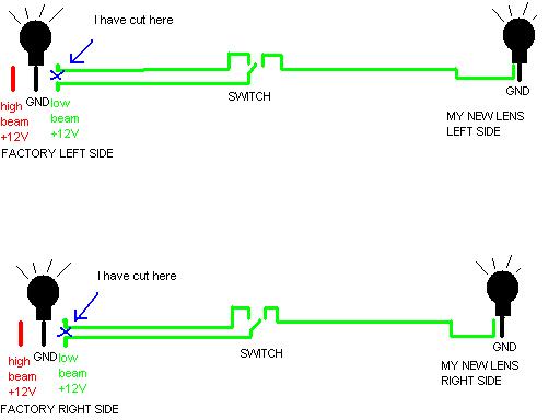

Hi,
I tried to make some improvements to my headlights. I throw away front fog lights and put Hella assymetrical lenses in that place (for low beam). I have cut the +12V at the factory bulbs and connected it via switch to be able to switch between my old factory lights and new lenses.
Problem is - when I switch on my lenses there is no parking (position) lights, and when I switch back to factory low beam all is OK. Of course I grounded the lenses, and when I switch them on, they work. I have made a picture of what I have done 🙂
If you have any idea, I appreciate.
Thanks in advance,
Tom

tomaszwl#7
Разница сопротивлений между заводскими лампами и вновь поставленными
I removed factory bulbs and use H4 bulbs - 60/55W - all is ok with using them. Park (position) lights are working fine.
New lenses are with H7 bulbs - 55W - I don't think that computer is able to detect this difference. Park (position) lights not working with them.
Strange thing - when I switch the main switch to first position I have only instrument cluster enlighted - position lights are not working. When I switch on low beam, then position lights are working.
Today I removed Front Control Module - between battery and left-front ligths, cleaned all, changed relays across positions, cleaned all ground connections to chassis, cleaned all FCM connections at the bottom - still no luck. As far as I read in service manual - I should replace FCM module.
All connections that I made are exactly like in attachment. I have found that somebody already 'fixed' something in main switch, because there is a additional wire connected. There is no difference if I disconnect that wire. It looks like somebody short-circuited position lights with low beam lights.
I will let you know when I find the reason.
Regards,
Tom

tomaszwl#9
Прошло ещё немного времени, и я наконец-то исправил проблему с фарами.
Как оказалось, причиной было несколько проблем одновременно -- одна была в распределительной коробке (Power Distribution box), причём с FCM всё было в порядке; вторая проблема была в том, что чудо-электрики соединили вместе лампы головного света и стоп-сигналы. После того, как я исправил проблему с распределительной коробкой, стоп-сигналы стали работать, но правая фара стала загораться одновременно с включением стоп-сигналов. Чудо-электрик, про которого я написал, соединил эти две цепи с правой фарой - это было причиной того, что стоп-сигналы включались с испорченной распределительной коробкой. Также это было причиной того, что стоп-сигналы работали только при включённых фарах. Я сделал несколько фотографий, чтобы можно было понять, что я имею в виду.
Если кому-нибудь интересны подробности - спрашивайте.
С уважением, Том.
