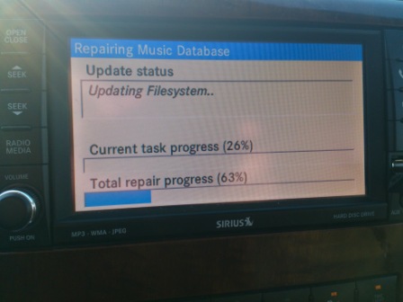

Попытался залить музыку с флэшки, выскочила такая процедура
Шла медленно и долго. Я оставил включенным питание. Через полтора часа пришел, все так же. Завел, скинулась. Но звука нет никакого, ни HDD, ни дисков, ни радио. Что делать?

Get#8
http://www.jk-forum.com/jk-electrical-lighting-sound-systems-13/mygig-cant-good-42216/
Вот тут вроде солюшн описан.
Mygig stuck in loop keeps saying "The Music database needs to be repaired" I click OK and it will perform update to the point of 96% then restart over and over again! I am in Moab right now an I cant believe it is doing this to me now!
It will not allow me to get to any other screen. They show up in the backround but this "The Music Database needs to be Updated" window will not allow me to do anything else.
Removed Fuse to reset the Mygig and the same thing happens.
Performed update to 9.702 and still does it.
OK this is the fix if this ever happens to you.
Pull the mygig fuse or disconnect the battery..
Quickly do these steps. It may take you a few trys to get the pattern right so be patient.
1. Plug fuse in and quickly go to the MYGIG. (run to passenger door!)
2. Press the soft button "Accept"
3. Press the hard button "Radio\Media"
4. Press hard button "Menu"
5. Press soft button "System Setup"
6. Press soft button "Manage HDD"
7. Press soft button "Delete all of my Music Files"
You must do this before the "Corrupt Music Database Files" ok screen shows up.
When you so hit step 7 relax you made it! just let it sit for 5 minutes for the files to delete and then click "OK" on the "Corrupt Music Database Files" screen and it will go to 100% and tell you some files will not be able to be accessed.
Then you are all set!
