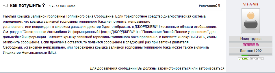

Loose Fuel Filler Cap Message If the vehicle diagnostic system determines that the fuel filler cap is loose, improperly
installed, or damaged, a loose gascap indicator will display in the EVIC telltale display area. Refer to “Electronic Vehicle Information Center (EVIC) in “Understanding Your Instrument Panel” for further information. Tighten the fuel filler cap properly and press the SELECT button to turn off the message. If the problem continues, the message will appear the next time the vehicle is started.
A loose, improperly installed, or damaged fuel filler cap may also turn on the Malfunction Indicator Light (MIL).

散裝燃料填料第信息如果車輛診斷系統確定燃填料上限是寬鬆、不恰當地安裝,或損毀,一個鬆散gascap指標將顯示在evic平整展示區。 提到“電子車輛資料中心(evic)在“了解你工具面板”,進一步資料。 進一步加強燃填料第妥善和新聞的選擇按鈕來關閉該消息。 如果問題仍未解決,這一信息將出現的下一次的車輛是開始。 一個鬆散,安裝不當,或損壞燃料填料上限可能會還打開了故障指示燈(mil)。 🎉

Вот как переводит яндекс 🎉
